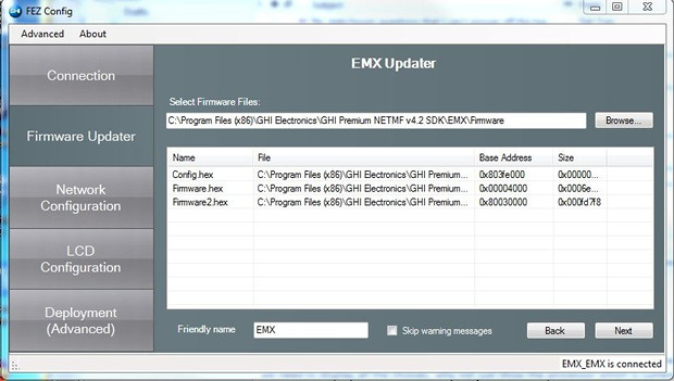

    To proceed with updating TinyCLR, click on the Firmware Updater button on the left and follow the instructions.
    FEZ Config Utility
    After FEZ Config selects the firmware and the default configuration files, click Next.
    Firmware and Config Files
